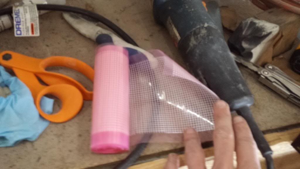

-Roll of reinforcement screening (adhesive backed)

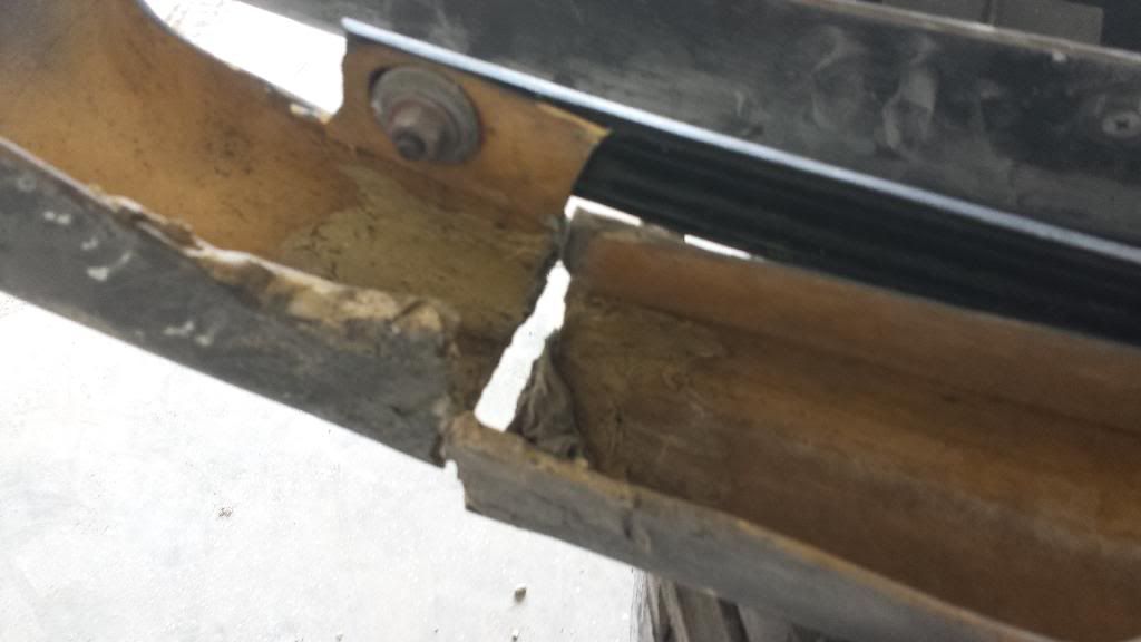

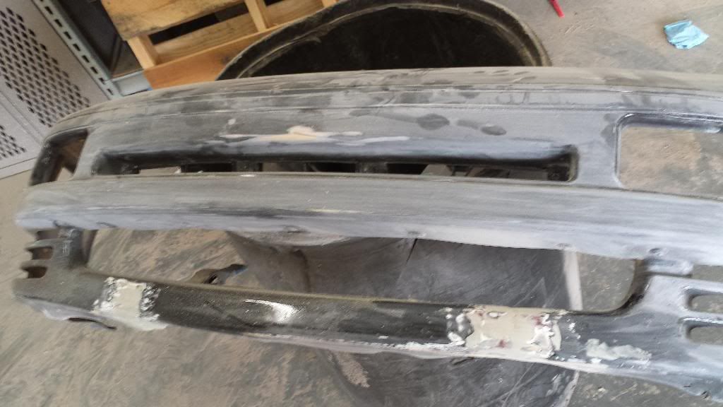

I started by washing down the bumper with my steam cleaner to help reduce contamination and cleanup further down the process. Next, I had the bumper flipped over on a stand and found this gem.
The previous owner had done some "repairs" and by coincidence that's exactly where my bumper split. They had used long strand fiberglass which has zero flexability which is why the repair snapped like a twig upon first glance.

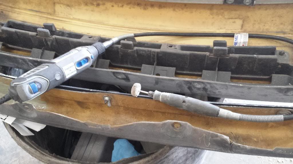

5 minutes and a Dremel with a 80grit sanding flap wheel later....
You want to prep the area down to the bare urethane/plastic, leaving a fairly rough surface (60-80grit range) and atleast 4-5" each way beyond the crack. Follow up by blowing the area clean of dust/debris with compressed air and then wiping clean with wax and grease remover to promote adhesion.

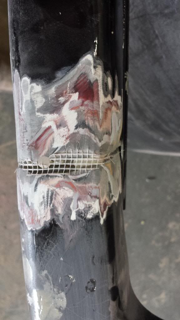

Next, use your clamps to hold/align the pieces as best as possible. It works out better jf you leave the front outer face slightly recessed so that adequate repair material can be used to ensure strong bond later.
(Slight fast forward example photo showing the front side after the rear is reinforced)

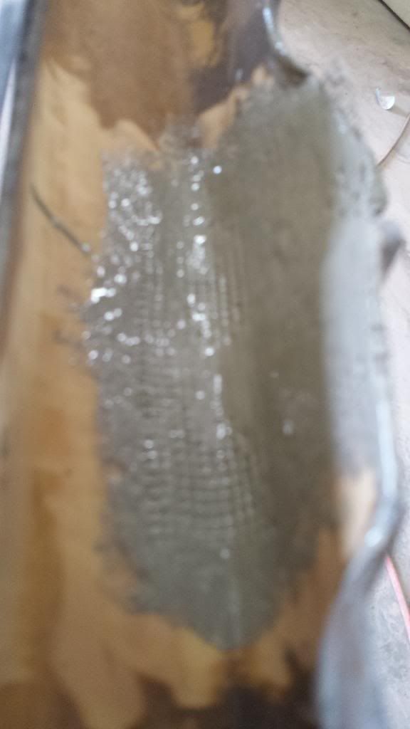

Cut two sections of the reinforcement mesh patch to cover the whole areas you have prepped. (Mine were roughly 6x10") Remove the backing and apply the first piece to bridge the crack. Follow up by making a half dollar sized batch of the SEM plastic repair material (mixing equal parts A&B) and applying over the whole repair patch area and an additional 1" beyond. Apply the second reinforcement patch on top of the recently applied filler within the 3-4minute range and press it in using your fingers. The "filler" type material will dry up in about 3-4 minutes so make multiple small batches opposed to one large one. If you do make one large one and don't use it all...it will atleast give you an excellent example as to why its a great repair material.
Fully cured, fully flexible without any cracking. Adhered to a slick plastic sheet and couldn't be pryed off. Should allow it to flow with the rest of the urethane bumper and deflect any future occurrences.

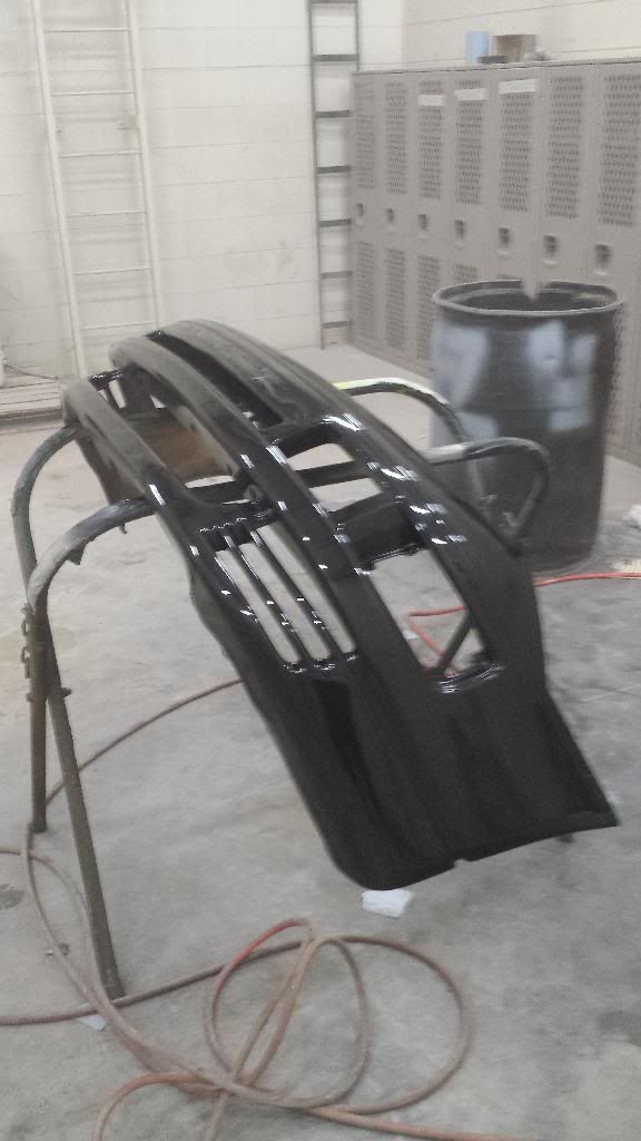

PPG DBU 732 Diamond Black Pearl basecoat and PPG 2002 Clearcoat
All in all, it cost me $70 for the SEM, reinforcement repair patch and wax and grease remover. I completed this whole process in 6hrs, followed up by 2 hrs of wet sanding and buffing the next day. I feel very satisfied with the results after seeing replacement fascias selling for $475 on many sites,
